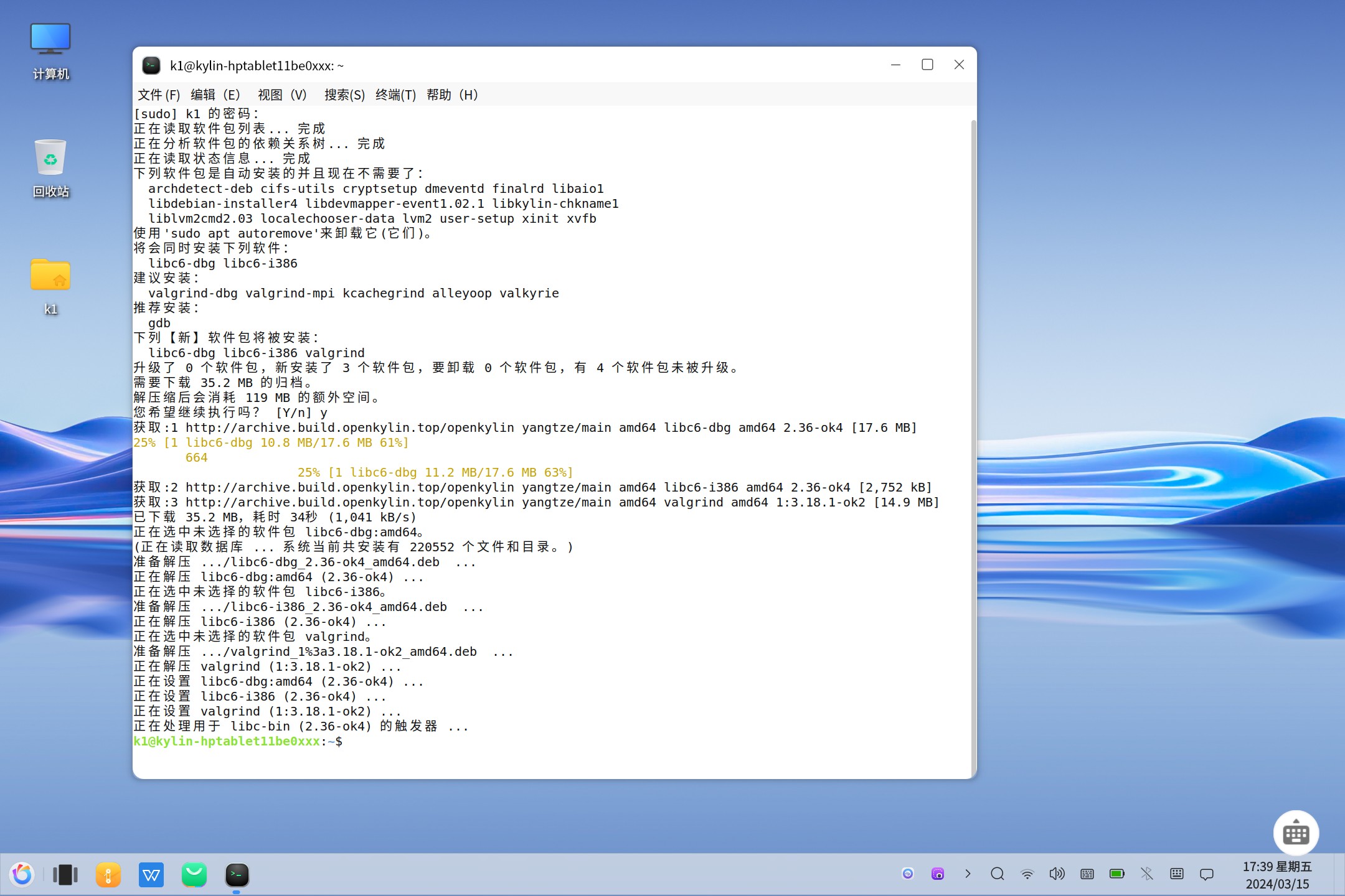

1.安装
使用下述代码安装Valgrind:
    sudo apt install valgrind

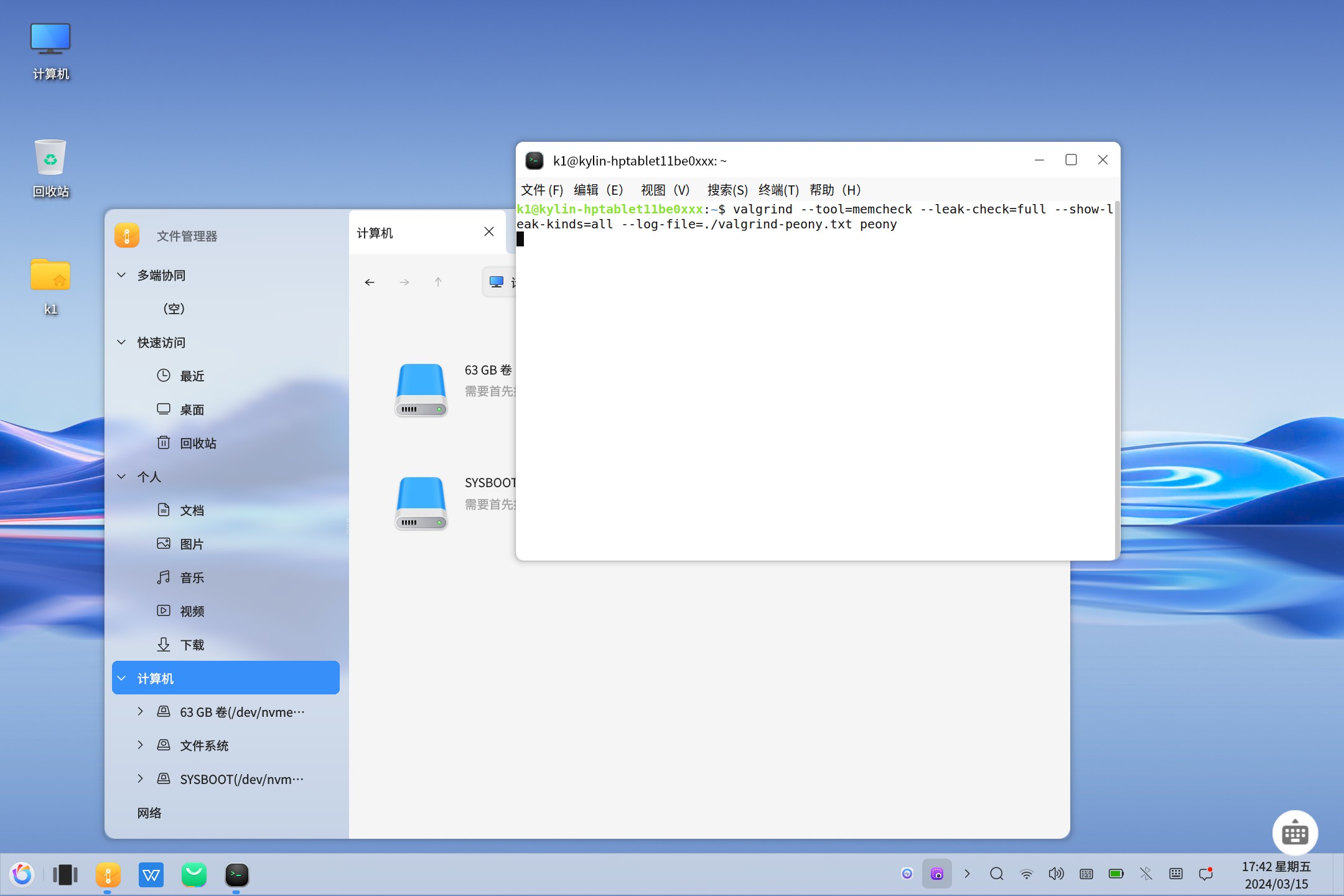

        • 指定分析数据获取(常用)
          valgrind --tool=memcheck [options] executable [args]
          举例:
            valgrind --tool=memcheck --leak-check=full --show-leak-kinds=all --log-file=./valgrind-peony.txt peony
            特点:可以定制分析指定内容,并配置各项输出结果等。

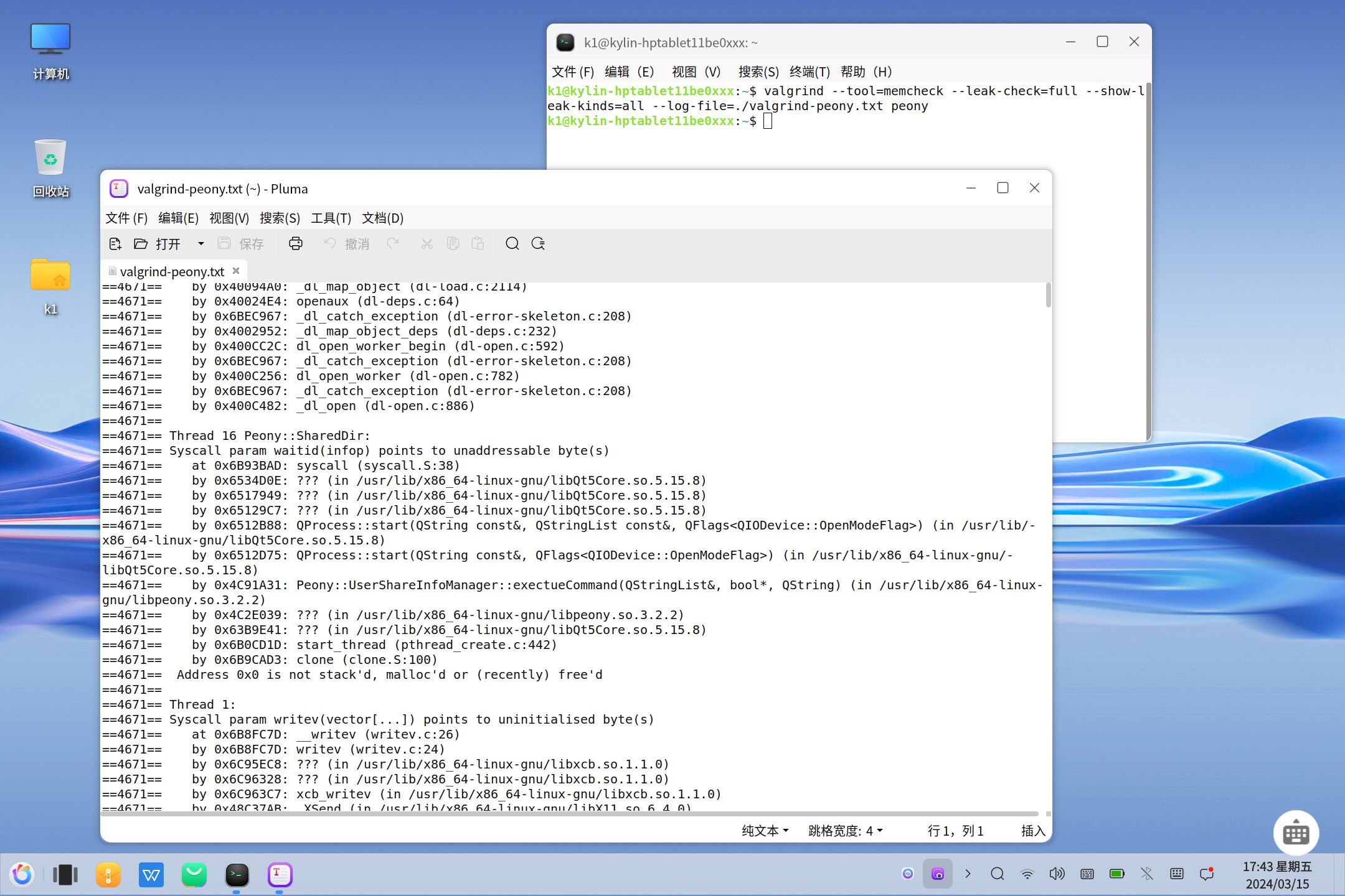

            6.分析说明举例
            此处以一个存在绝对漏洞的分析结果进行分析说明:
            首先,运行按照指令打开文件管理器,运行及常规操作完成后,关闭文件管理器,可以得到一个valgrind-peony.txt的分析结果,打开分析文本。
            找到一条Definitely lost的记录,并进行分析,将记录结果列举如下:
              ==295098== 8,408 (1,392 direct, 7,016 indirect) bytes in 1 blocks are definitely lost in loss record 2,355 of 2,361==295098==    at 0x483BE63: operator new(unsigned long) (in /usr/lib/x86_64-linux-gnu/valgrind/vgpreload_memcheck-amd64-linux.so)==295098==    by 0x105A25AD: Qt5UKUIStyle::Qt5UKUIStyle(bool, bool, QString) (in /usr/lib/x86_64-linux-gnu/qt5/plugins/styles/libqt5-style-ukui.so)==295098==    by 0x105A07F4: Qt5UKUIStylePlugin::create(QString const&) (in /usr/lib/x86_64-linux-gnu/qt5/plugins/styles/libqt5-style-ukui.so)==295098==    by 0x5553BF9: QStyleFactory::create(QString const&) (in /usr/lib/x86_64-linux-gnu/libQt5Widgets.so.5.12.12)==295098==    by 0x557B2DF: QProxyStyle::QProxyStyle(QString const&) (in /usr/lib/x86_64-linux-gnu/libQt5Widgets.so.5.12.12)==295098==    by 0x1041E58C: UKUI::ProxyStyle::ProxyStyle(QString const&) (in /usr/lib/x86_64-linux-gnu/qt5/plugins/styles/libukui-proxy-style.so)==295098==    by 0x1041FD3A: UKUI::ProxyStylePlugin::create(QString const&) (in /usr/lib/x86_64-linux-gnu/qt5/plugins/styles/libukui-proxy-style.so)==295098==    by 0x5553BF9: QStyleFactory::create(QString const&) (in /usr/lib/x86_64-linux-gnu/libQt5Widgets.so.5.12.12)==295098==    by 0x54E6041: QApplication::style() (in /usr/lib/x86_64-linux-gnu/libQt5Widgets.so.5.12.12)==295098==    by 0x54E639C: QApplicationPrivate::initialize() (in /usr/lib/x86_64-linux-gnu/libQt5Widgets.so.5.12.12)==295098==    by 0x54E63F7: QApplicationPrivate::init() (in /usr/lib/x86_64-linux-gnu/libQt5Widgets.so.5.12.12)==295098==    by 0x13EC10: SingleApplication::SingleApplication(int&, char**, char const*, bool, QFlagsSingleApplication::Mode, int) (singleapplication.cpp:40)
              上述反馈结果可以得出以下分析:
              根据Valgrind输出,可以看到loss record 2,355 of 2,361中有8,408字节的内存在1个堆块中被明确地丢失。具体的丢失堆块的分配和释放情况如下所示:
              • 在函数Qt5UKUIStyle::Qt5UKUIStyle(bool, bool, QString)中,通过operator new(unsigned long)进行了内存分配,但没有相应的释放操作。
              • 这个失去的堆块在libqt5-style-ukui.so库中的Qt5UKUIStylePlugin::create(QString const&)函数被创建。
              • 接着由libqt5-style-ukui.so库通过QStyleFactory::create(QString const&)函数创建了QProxyStyle对象。
              • QProxyStyle对象进一步由libukui-proxy-style.so库UKUI::ProxyStyle::ProxyStyle (QString const&)函数创建。
              • 在此之后,又通过libukui-proxy-style.so库中的UKUI::ProxyStylePlugin::create(QString const&)函数通过QStyleFactory::create(QString const&)函数的调用创建了QProxyStyle对象。
              在调用栈的最后,这段丢失的内存是在单独应用程序的构造函数SingleApplication::SingleApplication(int&,char**,char const*, bool, QFlags<SingleApplication::Mode>, int)中出现的。
              Valgrind的输出表明,在这些函数的执行过程中,没有释放掉先前分配的内存。这样的内存泄漏可能会导致程序运行时内存使用过多,最终可能会导致性能下降或崩溃。
              最后进一步修改代码,将未释放的内存进行释放。然后再次进行分析验证。
